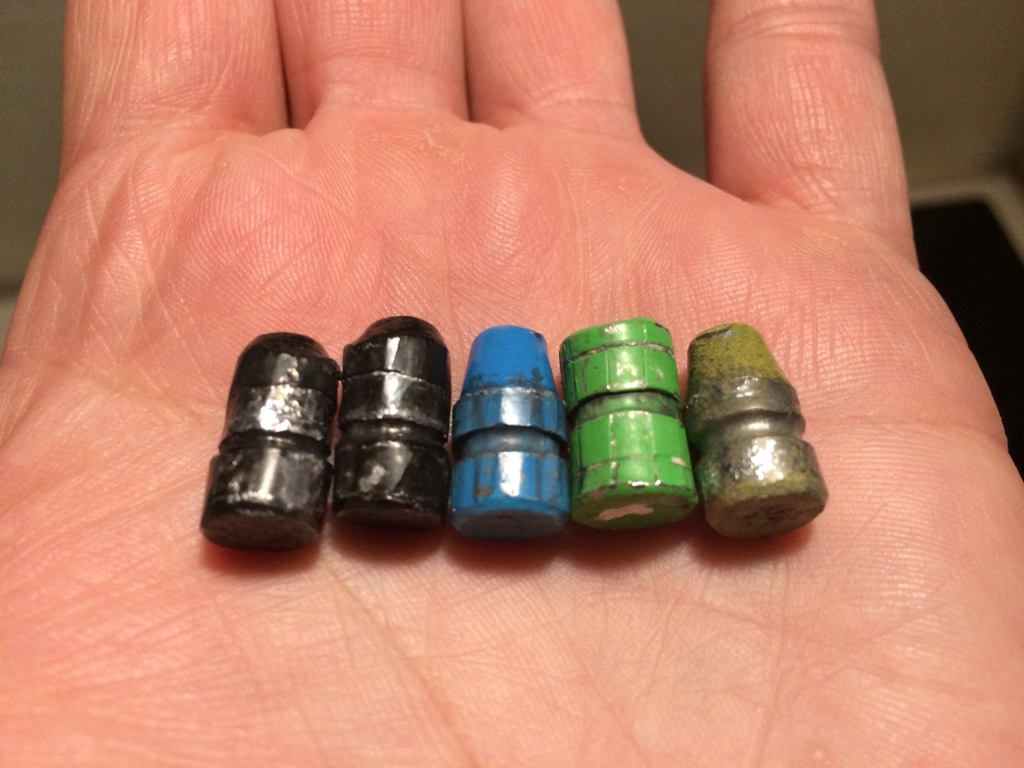

Garret did you ever recover the bullets? I would love to see what they looked like. I did testing with recovered bullets to understand alloy hardness, coating, sizing and loading variations. Swimming pools are awesome for more than swimming. There is just too much variation. It is not easy. Plated is just easier and faster and I do most of my reloading with them.

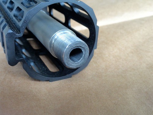

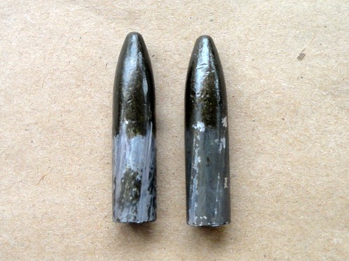

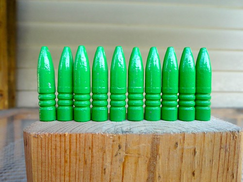

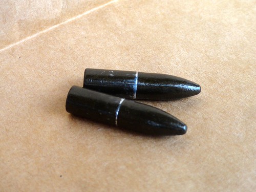

A new world was opened to me when I joined http://castboolits.gunloads.com/forum.php. I spent a year reading about the science and art of casting, loading and coating bullets. I am not an expert and it my be a while before I feel practically competent. One of the things about coated bullets is barrels should be completely cleaned to have the best bore protection. Switching between jacketed, plated and coated bullets is not the best practice.

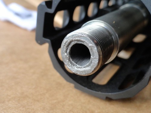

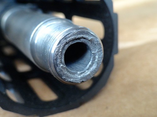

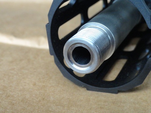

I spent months of frustration trying to make a bullet that would not foul my 300 blackout. Turned out my Seekins Precision barrel's was out of spec, bore too small. They sent me a replacement. I also want to give Leatherhead Bullets (now a new company) a big thank you for working with me on that. They sent me many different Hi-Tek coated bullets for testing. Another big thank you to many members of other boards who helped.
Here are some teaser pictures from the testing.
m
Coated bullets are not the best solution but they can be another option, Benefits are cost, easier cleaning, less friction, much less barrel wear, cooler barrels. I'm sure the technology will get better as more manufacturers start selling them.

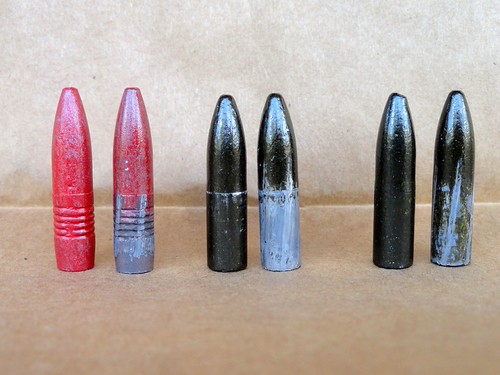

Here are more pictures proving how different coatings and coating processes are not equal. Keep in mind that if you can see the lands cut through the coating, there will be lead. I personally think HiTek coated bullets are more likely to cause problems that powder coated bullets. More people sell HiTek because it is easier, faster looks cleaner than PC. I did notice that Federal is selling the PC now.
