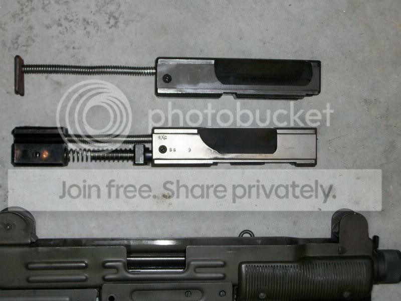

Correct on all but one point. The CB setup does operate the same as an OB once the first shot in a burst is fired, with the firing pin protruding through the breech face the entire time.
However, it's not faster because the bolt is lighter. It's marginally faster from the added spring pressure from the striker spring. But it is mostly faster because the rear of the striker assembly and the buffer take around 2" out of the bolt's travel. On a subgun, that's pretty substantial. It's like a MACJack on an M11, but more so.
Here's a picture of the two so you can see what I mean.
This is the stock CB setup anyway. I've modified another set so it slows the thing down to at least manageable levels.

4,112
Garret
It makes sense.
only NFA's I have Xperience with are a B&G cut from the front to make a mini bolt and a closed bolt slotted.
'I always figured the material taken from the bolt made it faster never thought of the spring for the striker.
Lesson learned and will keep it as "now I know why"
