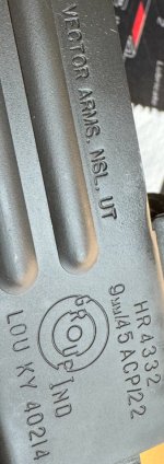

Thanks, @navgunner. That seems to have done the trick. The bolt that came with the gun carries the stamp below. I am seeing indication of South African manufacture? Any ideas?IMG_5124.jpeg
