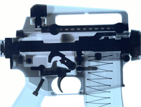

Kind of cool to see this post. I work at a place that does industrial casting but x-raying non work stuff is a big no no......That being said,:) it wouldent be too hard to do but as with most places bringing guns into work never goes over well.
something like a receiver would be pretty easy, generally it's about a inch or less thick, and some sort of steel alloy (we generally do inchonel, stainless steel, rene and hastolly) so your looking at something around a 220-270kv shot for about 1.2-2.0 min depending on film speed and tube height (tube to film distance). I've never worked with medical, dentists equipment but I dont know if it would be strong enough kv wise (penetrating power) because most of it's designed to go through bone/tissue and do it very quickly.
Your best bet would be as mentioned to go to someone/place that does this and see if they use digital stuff. Usually film is more expensive and may take a few tries if they are dealing with a unknown. That being said thing like shoes, candy bars and hobby cars are much more challenging to x-ray I've been told. http://i531.photobucket.com/albums/dd353/SWMR2/IMG_1847.jpg?t=1292795090
