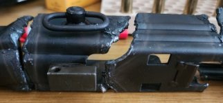

Recently picked up another kit, and I'd like You experts to opine on its production era? It has a steel feed ramp and the rear handguard mount is also welded steel and also serves as the front mount for the grip frame.
I'd appreciate translation of the stub markings too as I have no knowledge of Hebrew.
Thanks.

Ahhh, Grasshopper, you must buy the book, “The Uzi Submachine Gun Explained” by David Gaboury (uzitalk site owner) and then you, too, shall know everything there is to know about Uzi’s.

Hello and welcome! Check out the Home page here, FAQ's etc. for detailed info. The Book mentioned is a great source also - looks like you have a nice parts kit there. For specific details you'll have to do some google digging. I don't read Hebrew and haven't seen any *Lists of Markings. This is a good article: https://www.americanrifleman.org/content/an-essential-uzi-guide/
1,349
All the book has is a photo of both types and says the combo bracket was the early type.
I forget what it's called but there is a translation app for your phone where you use the camera to hover over the lettering and it will translate.

Okay, per The Book (pg 41), the top row of Hebrew characters says, “Uzi machine gun”. The 2nd row: first character is a number followed by “version 2” followed by another number. Then the ser no (probably 50’s or 60’s manufacture). Bottom row translates to “Maflan” which was a small arms division of IMI. If you got an og IMI fire control group with your kit then the three Hebrew letters you need know are R to L, Natzur (safe), Bodedet (single), and Otomatit (automatic).
Definitely get the book.

Thank you for the detailed answer I would have swore this was a late manufacture not early. I've never seen a kit with this kind of handguard mount or a machined and welded feed ramp. I'll look for the book too.

The machined/welded feed ramp and grip lug are of the early type, like Slimshady said. Later they went to a stamped feed ramp and stamped pocket instead of the grip lug to save on manufacturing costs. You can definitely reuse the machined feed ramp by carefully grinding away the two weld blobs on the bottom of the receiver and sliding the ramp out of there. It goes right back in the new repair section the same way. Repair sections come with the stamped pocket so the grip lug is less useable.
