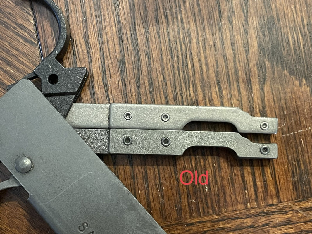

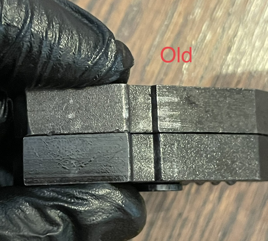

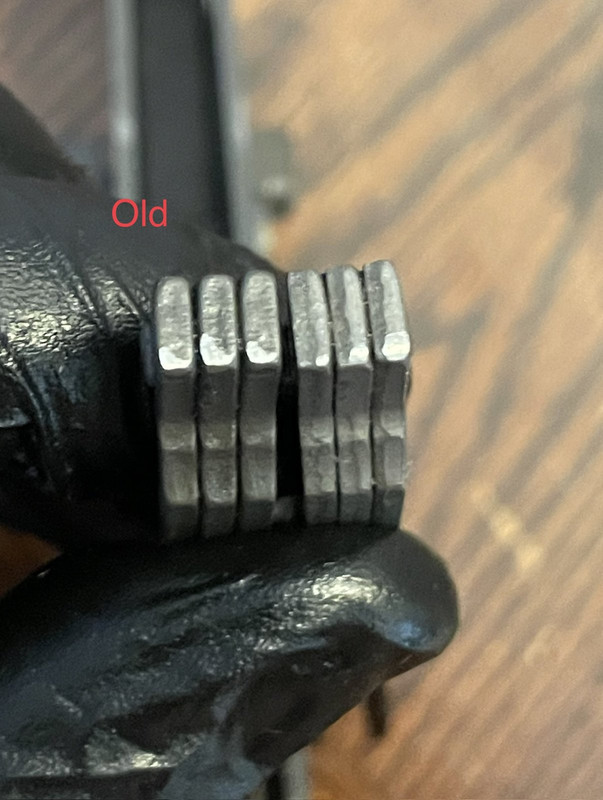

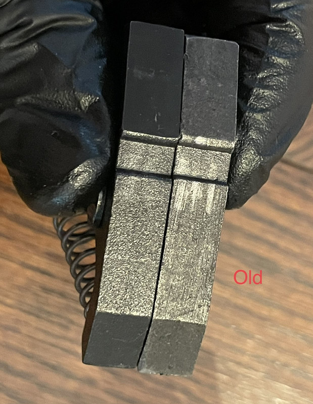

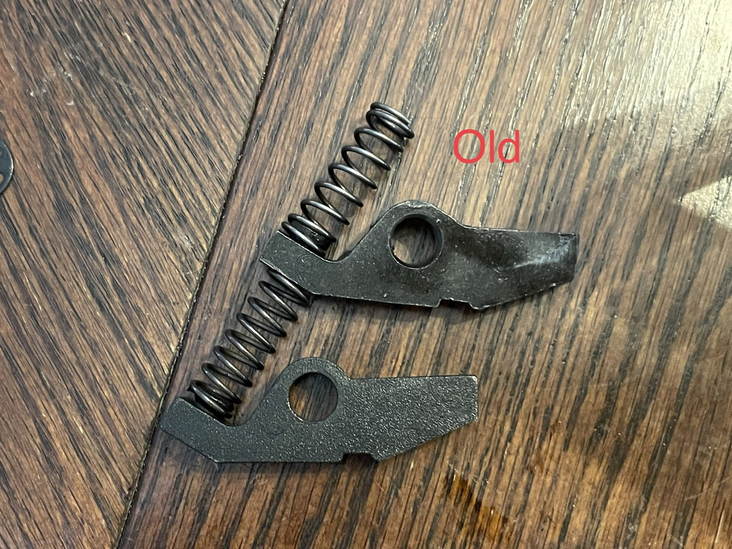

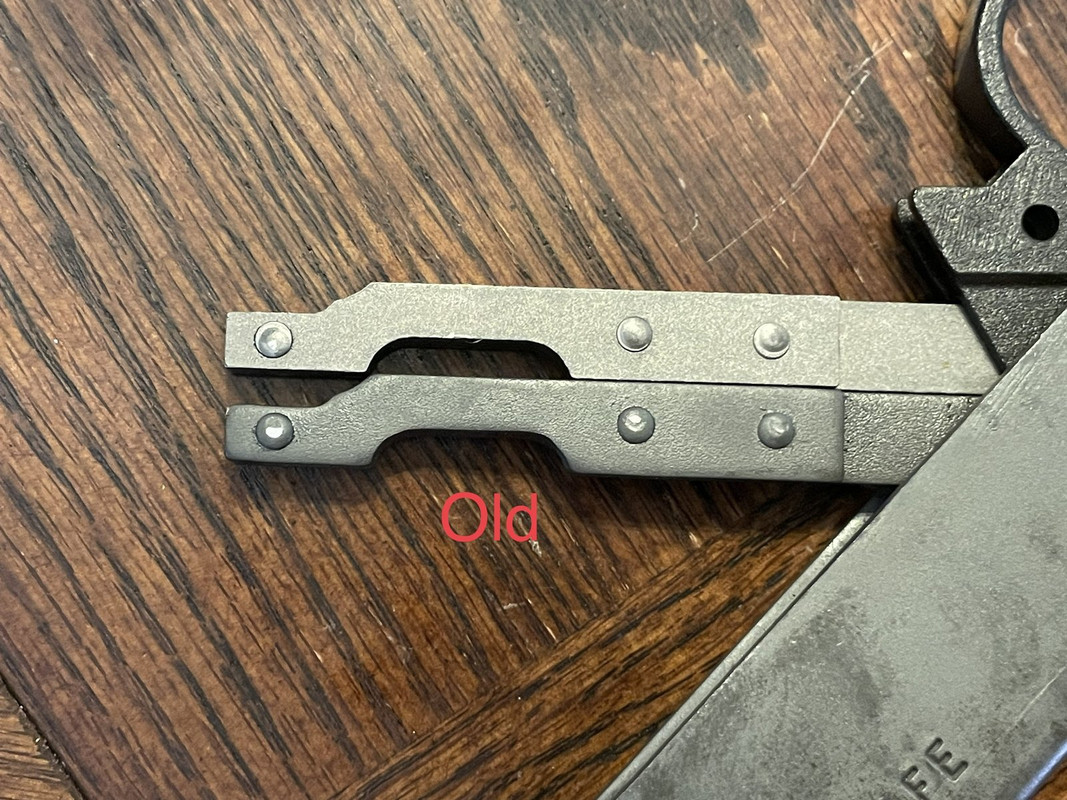

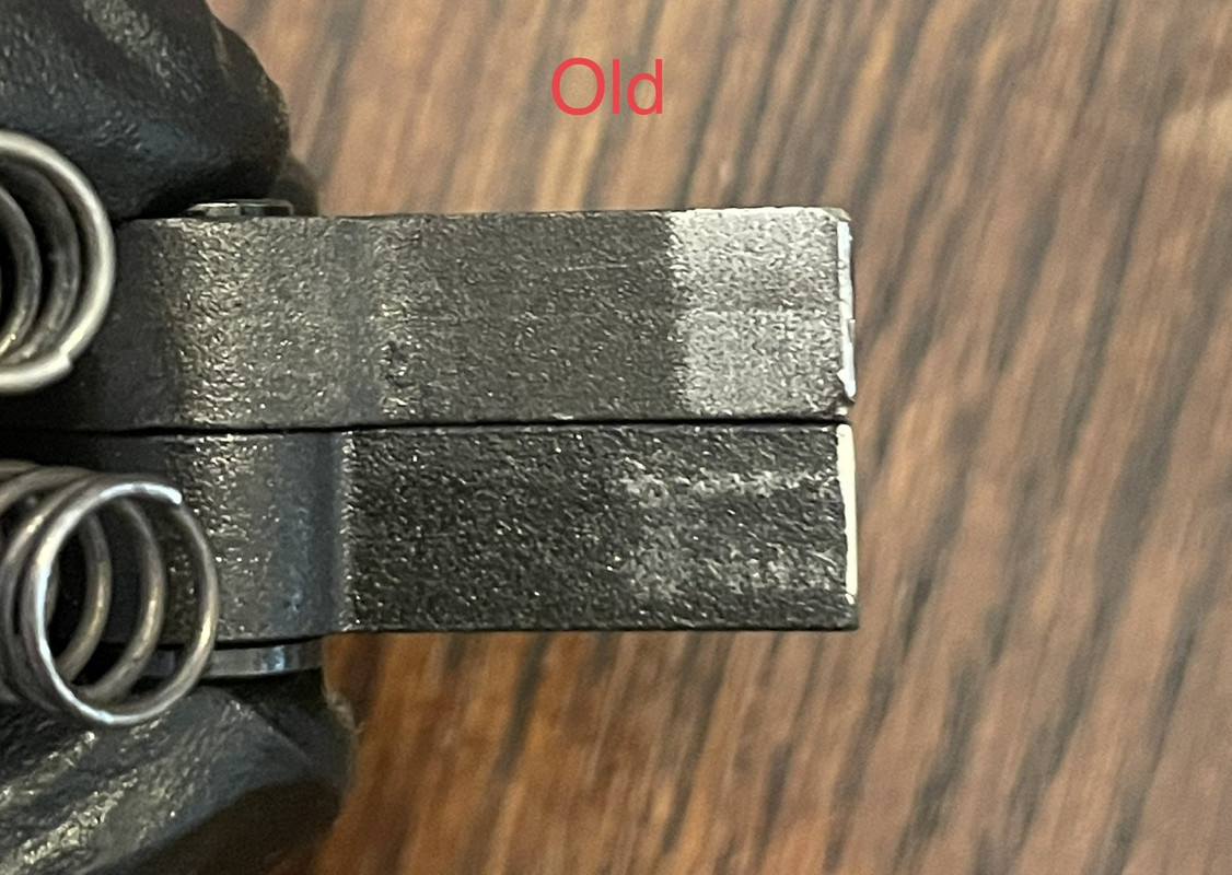

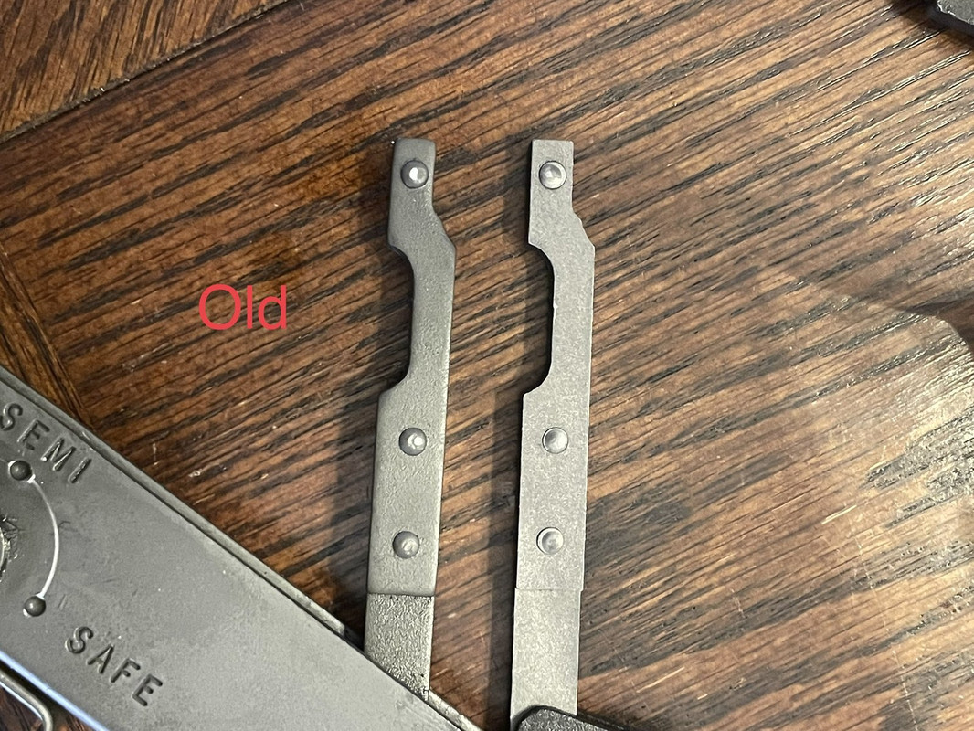

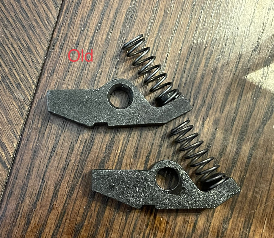

1,464
Some (possible) good news. I changed the sear out I my MK760 and it appears to function fine. I’m going to test it today and report back. My gun had an issue with the sear releasing and I assumed it was the sear and/or the trigger bar. After changing the sear, it works as it should.
A few photos below (new vs old), maybe they’ll help someone.
Trigger bar:
Sear (pin is inserted in some photos, for alignment):
The red text with “old” indicates the original part, in my gun.
