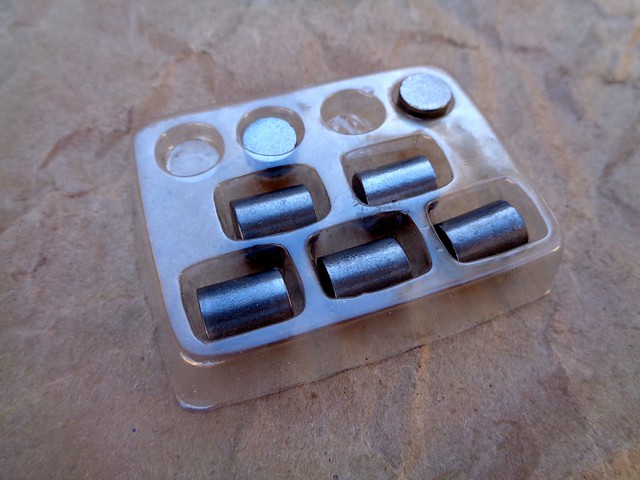

I played around with some tungsten a.k.a "W" weights I found at Hobby Lobby (used for pine wood derby cars) to slow the ROF.

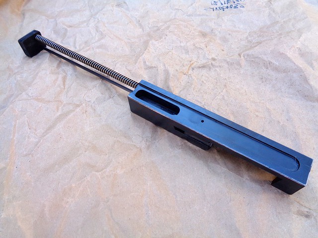

Here is the current Max-31K bolt.
Here is the selection of W weights. I used all 5 big weights. Collectively it added 2.45 oz to the bolt.
https://www.hobbylobby.com/Crafts-H...g/Pine-Cars/Cylinder-Tungsten-Weights/p/26239

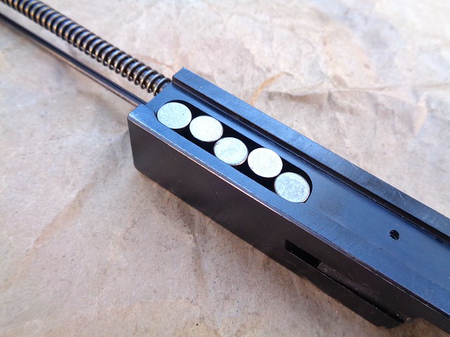

Here is the W in the bolt.
It reduced the ROF from 731 to 589.
In either bolt configuration, the bolt never made contact with the buffer. I think the weights made shooting less bouncy.

Any concern the extra weight will damage your gun? There’s gotta be a reason Lage chose the rpm vs bolt size vs spring .

I don't think the added weight to the K bolt would hurt the gun. The Gen2 K bolt is very close in weight to the Gen2 31A bolt. 31A complete bolt assembly is 552 grams, and the 31K is 511 grams and 31K + W is 583 grams. The main difference between the systems is barrel length. I think the only problem could be how hard the bolt hits the sear, but since Richard relocated the sear notch further back on the bolt and the fact the bolt does not have the speed/force to hit the sear hard. Weight would make the bolt recoil less and have less force to hit the sear.
Richard removed weight from the K bolt over the 31A bolt because of the shorter barrel and the change in resistance between steel and aluminum uppers. Richard has a manufacture perspective. Parts commonality is a factor.
Of coarse, I could be wrong. :)
Do you plan to epoxy or solder the weights in place?
I have no plans to epoxy the weights into the well. I like that they are easily removable. I did tape the weights together for a snug fit to avoid movement in the bolt.

You will get wear marks on the inside top of the upper. The weights will bounce around a little when firing. I did a similar experiment with the MAX-10/31.
When we design the bolt for each gun, we test it with a wide variety of ammo. You never know what ammo a customer is going to use. Weaker ammo can be problematic, so we make sure the gun will work with it also. So, yes, there is room to tune it for a specific brand/spec of ammo.
