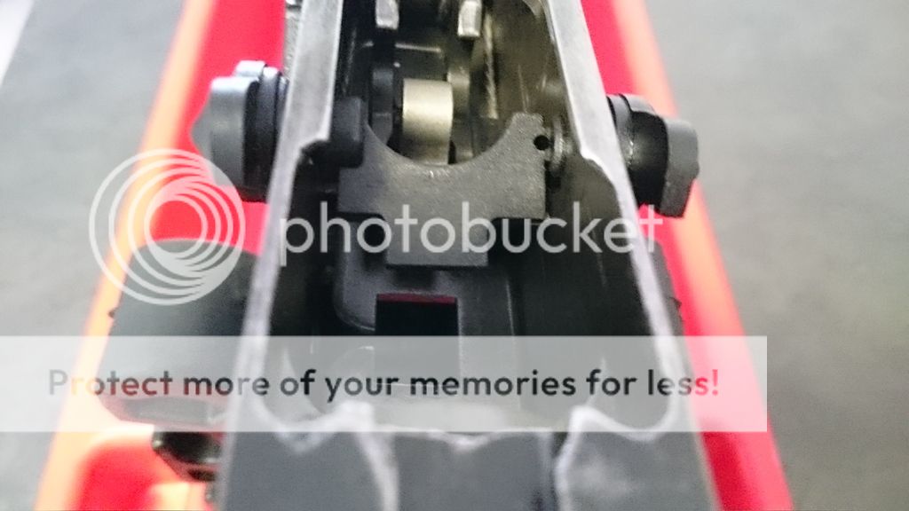

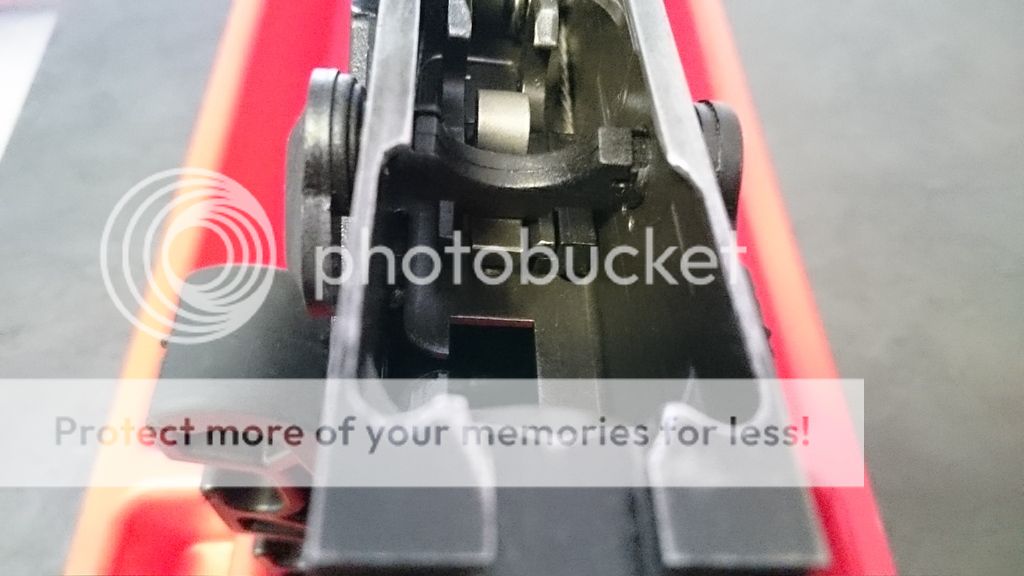

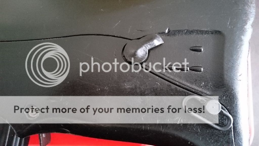

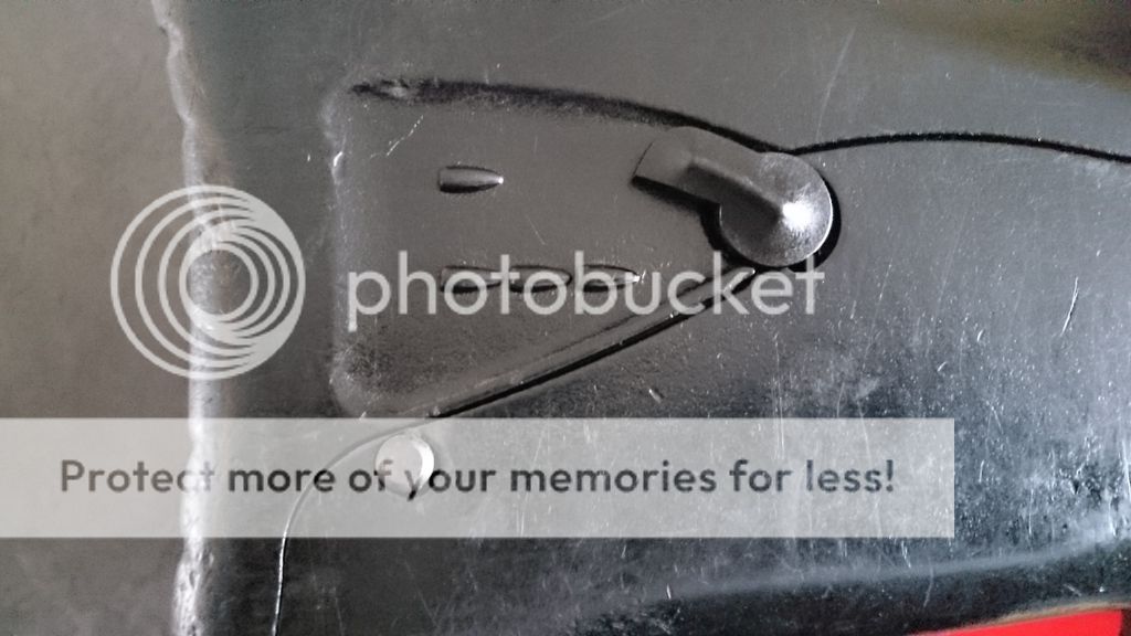

The assemlbed rifle showing the left hand side change lever. Note the retaining pin going through the body and the rifle receiver with the rifle sling loop.
The right hand side of the rifle showing the change lever
