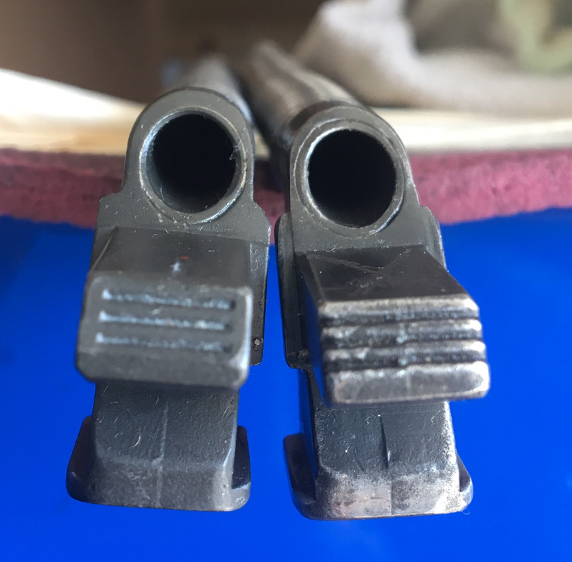

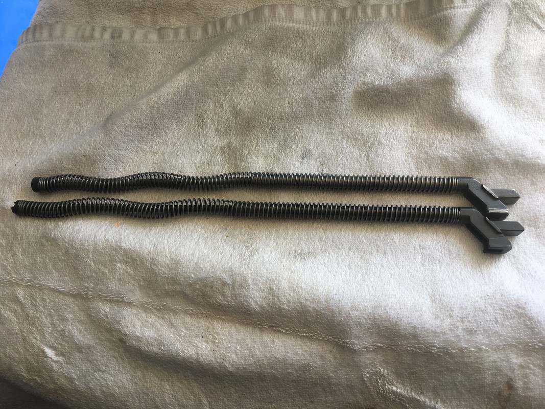

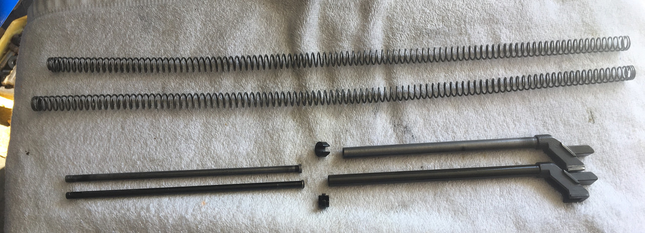

Differences on recoil rod assembly.
Galil on the left has a wider shoulder and machine is different shape. Ends are also machined differently.
Galil assembly on bottom is significantly longer.
Galil spring and back part of the rod is longer. Galil spring retainer can be installed on both ends, R series only on one end. Galil telescoping rod end is chamfered, R series is squared. Both have the same length.

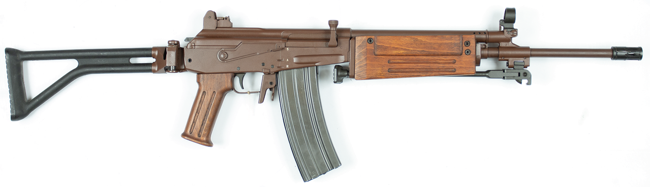

This post popped up on a gun forum in South Africa. I asked the original poster for their permission to share the post and they were happy for me to share.
This weekend, I photographed an odd Vektor R4 in a private Swiss collection.
The rifle itself matches a brown R4 that I photographed a few years ago.. But with oddball wood furniture that doesn't match anything I have seen. The owner said that this is how he bought it, and it was in one other collectors hands since importation 30 year ago. Said that the story he was told was that this was sometimes down by SA Army Sergeants and the like as some sort of status symbol, and there is a Dutch (Afrikaner?) name engraved in the pistol grip, but the rifle is brand new.
Serial number is in the 789xxx range. The earlier one I photographed was in the 799xxx range.
Anyone know if this is legitimate, or just some sort of collector dolling up his rifle?

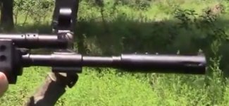

Hey y'all, thanks for the info on this thread, its great stuff.
It seems like some R4 rifles have rectangular selector notches instead of the usual pointed oval. Any idea why/when that was done?
Also, in mishaco's LM5 video, he had an XM177 style muzzle device that he said came welded on from SA due to USA gun laws. Did any organization in SA use an XM177 style muzzle device?
