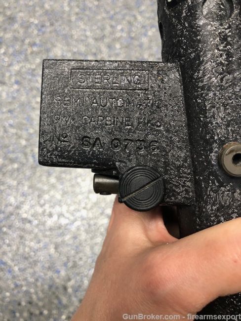

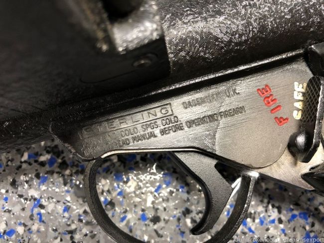

Note the different S/N configuration and application of importer markings for what I would surmise is an early Cassi import
