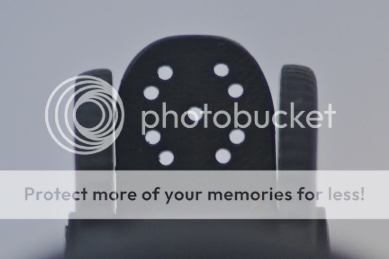

Many Uzi owners have drilled and opened up the 100 meter rear peep sight. I didn't have the same problem as you, but I drilled mine out to increase the speed in which I could pick up the front sight. This was especially useful in matches where speed matters and I highly recommend this for Uzi owners and I'm betting Sterling owners may find this useful as well. I'm thinking you have a spare parts kit so this may be worth a try with a spare sight.

The current trend is to use only the rear stud to mount an optic much closer to the rear sight which allows the shooter to quickly and easily acquire the dot in the small window. This set up is depicted in the photo below.

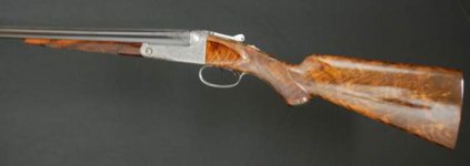

I reckon not. Same reason I would not paint this stock
The reason I mention it is because the company could make a basic stock with a painted finish versus a beautifully finished version as pictured.
