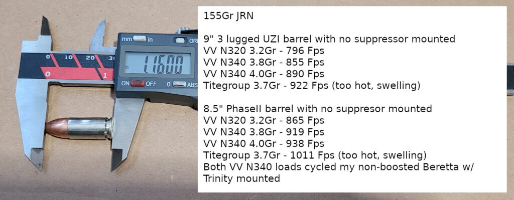

I used to run Berry's 147 JRN exclusively for at least 5 years till I got a few batches that were undersized. I was paying extra for their DS - Double Struck bullets too. They were like .354 and they are supposed to be .356 since they are plated. They wouldn't do anything for me. So that pissed me off and I never bought from them again.
I only noticed that they were undersized as I was having accuracy issues in certain barrels. I know for certain that one of the barrels was my polygonal rifled IMI Mini barrels didn't like them while some other UZI barrels they were fine. I did more testing and found that jacketed was just more accurate across all my 9mm guns so decided to just skip on plated bullets.
Back then I switched to Precision Delta JRN (NOT plated) which was cheaper than the Berry's back then.
Today, I've been just buying jacketed 'blems' from American Reloading. Most of the time, I don't see any marks on the blems.
I just got a bunch of these 155GR JRN and they have been great. Great price and I'm amazed they still have any in stock.
https://americanreloading.com/product/9mm-155gr-fmj-blems-500ct/
46.74 delivered for 500 is hard to beat.
Probably because 155 is an oddball weight and most people don't want to deal with something different.

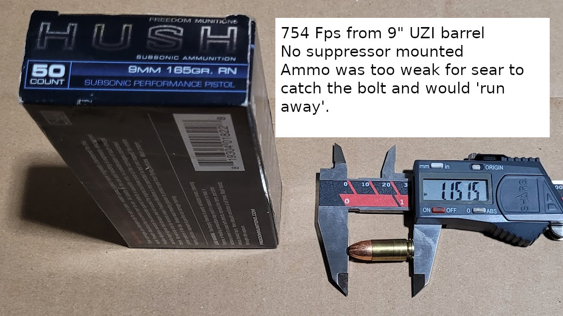

freedom munitions has some round nose 147's that have ran good in the past. Haven't bought any in a while though. They also have a HUSH line for suppressed fire, but I have not tried them. They are a 165gr. round nose at 800 FPS.
I coincidentally shot some on Saturday:
It was also too weak to cycle my unboosted Beretta.

Care to share your load for the 155s?
