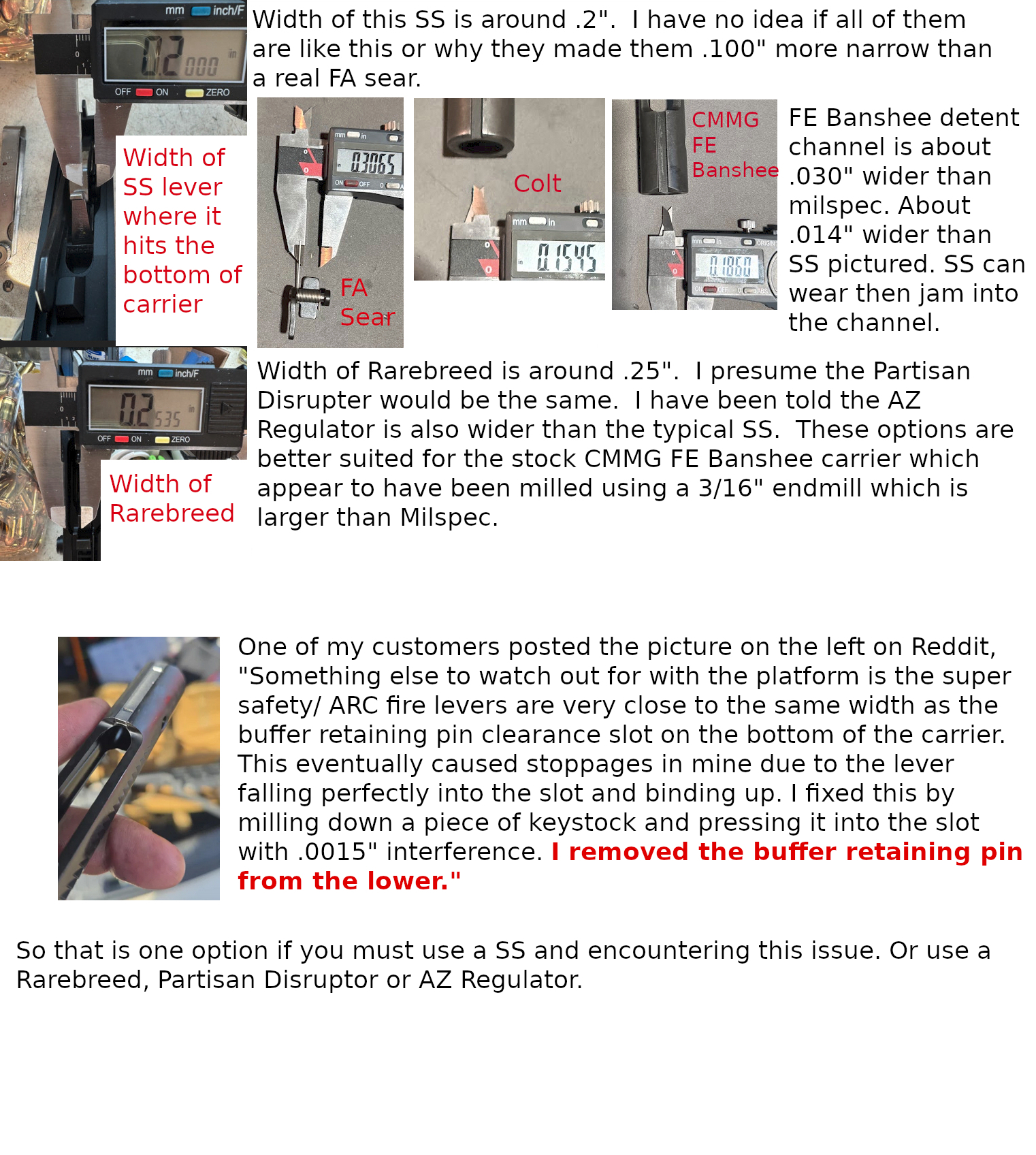

Regarding the magnetic buffer see this thread on Reddit:
Guy is saying that the magnetic buffer magnetizing the carrier which in turn attracts the SS and causes issues.
I posted that it shouldn't be an issue with an FRT like the RB, Partisan Disruptor or maybe the AZ Regulator.
Again, I'm in FL and don't have any of these.
I also put this picture up on my site regarding the FE Banshee carrier detent channel being an issue with SS's.
So that is another reason an FRT may be better suited for the FE Banshee.
I have a FE Banshee in .45 aslo but I just don't shoot .45 enough. I tested it with my ARS setup and it ran fine and I put it away. Too busy playing around with 9mm.

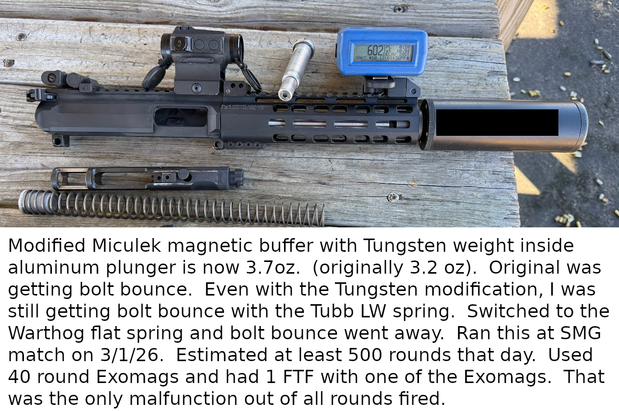

Picture below is what I ran at the last SMG match (9mm).
The Miculek magnetic isn't reliable in full auto for me in the 9mm CMMG RDB. I would suspect it woudln't be reliable in .45 either. As you can see in the picture above, I modified mine with a Tungsten insert. The buffer is also 'permanently' assembled so you cannot swap out the plunger.
I have now made my own that is intended to be fully taken apart so I can swap plungers of different weights and lengths as well as use spacers instead of relying on a screw to adjust the strength.
Again, my goal here is a slow cyclic rate (around 600RPM) but with the lowest amount of reciprocating mass as possible. In the picture above, my lightened carrier is 9oz and with the 3.7oz magnetic buffer I'm at 12.7oz of total reciprocating mass which is insane to me. I don't think there is any closed bolt 9mm SMG that can shoot that slow with this low amount of mass. For that matter even considering an open bolt SMG, the bolt is going to weigh more than this as well.
Once I am happy with my own magnetic buffer, I want to see if I can do the same thing in .45ACP with low mass and a slow cyclic rate with my 45 FE Banshee.
