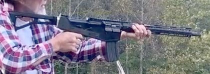

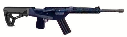

Using a freeze frame from the teaser video posted last night, I spent some time today creating my “artist rendering” of what the assembled firearm must look like. But, now, having done that, I see they’ve posted a more revealing video that makes my effort pointless. I’m still posting it just so I get it out of my system and won’t feel like I totally wasted my time.
Using a different freeze frame from yesterday, I measured the angle between the upper and the lower to be about 10 degrees. So whether the upper is angled 10 degrees up or the lower is angled 10 degrees down, I figured there would have to be some type of “wedge” stock adapter so I included that in my rendering also.
I very much look forward to this product coming to market. The Lage MAX-11/15 upper will have the advantage in weight but the Tenco 10/16 (and for me 11/16) will have the advantage in configuration flexibility. They are both great concepts. Choice is usually a good thing but this is definitely going to cost me more money.

Looks doable! Why the angle though?
This is an adapter that is going from open bolt M10 fire control to closed bolt M16 function. The closed bolt fire control is on top of the M10 fire control. With two systems one on top of the other, if the M10 is not tipped down, the bore axis would be above the back of the M10 receiver. The end of the buffer spring must bare on the back of the M10 receiver or the adapter might be considered a firearm.
