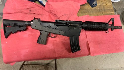

Here is a pic from the side that is Tina approved.
3,186
Ok more questions
  1. Is it aluminum or steel
  2. Is this a TASK style design with a hole through the back plate?
  3. Is this design even feasible for the 11/9? It is longer in the rear, and if there is a requirement for buffer tube continuity that would seem to impact the dimensions.
1-Billet aluminum
2-No modifications to the M10 RR.
3-We think we have way to deal with the extra length of the M11/NINE receiver to be used with the adapter system.

Well I'll say the pic of the entire gun does look good.
Vegas how does it fell weight wise and balance wise?
Thank you for posting the picture Sam. The lever in the back is not a selector. That is a buffer retainer lever. The PDW off the shelf AR buffering system uses buffers designed to slip inside the back of the carrier. They offer H1, H2, H3, 9mm and a super heavy all tungsten constructed buffer. Plus a recoil spring system for 5.56X45/9mm and a heavier spring system for piston or belt fed systems. We plan to ship with the standard spring and a H2 buffer. The line coming from the captured rear pin is for the extra material around the detent hole in the adapter. The front detent hole is in the angled reinforced at the front of the adapter. The bolt/carrier assembly is chromium boron coating for ease of cleaning. The small rail at the back is the same height and plane as the flat top upper. So it is possible to mount an AR rear iron sign near the user's eye.

What type of stock adapter is being used to keep the bore line centered to the stock? Looks like it’s wedge shaped. Does that come with the adapter?

I get the reason for it all and the need to do it like this but I’m not positive I can get into how Frankenstein looking it is. Is the lower really not uncomfortable angled like that?

Interesting that the position of the AR upper essentially positions the charging handle like a side charger.
Any thought to a loaner. You can charge my card full price and I return it for after I demo it? Not sure I can drop that much coin not holding it. Maybe just me but my pockets are not as deep as many on here
Not comfortable?! Like the angled grip of an AR, AK, FAL, FNC, etc.? Most modern handguns in the world today have angled grips.
