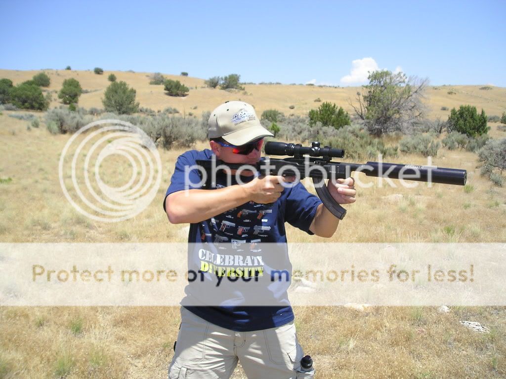

Fun toys, well worth doing.
5.5 inch barrel, custom folder I build in house.

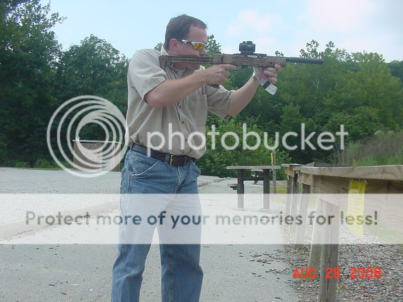

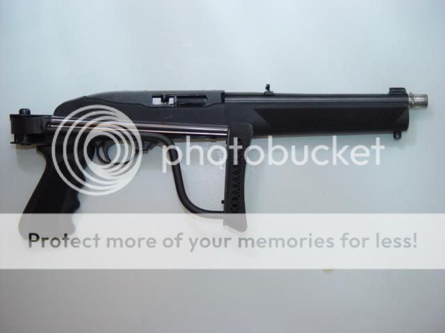

Garrett, are those 3 different guns, or just the same gun in different set ups? And is that a 9mm SMG can on the pic in the middle?
I'll be working on my Form 1 this week I guess...
2,829
Same gun - over about a 10-year period. It's a Bowers .45 can in the middle picture. :allright
I've run that can on just about any common non-rifle caliber you can think of, from .44 mag on down.
On the 10/22 I originally had a stainless factory barrel that I'd had cut back to 4" and threaded. Accuracy was crap (probably due to the barrel its self, and not the length), and it would not cycle reliably without a can on it. But anything short of CCI stingers stayed subsonic in it. I later went to a 5.5" Lilja barrel. Accuracy was much better, it would run without a can (surprisingly loud without one, too), but you had to be careful what you fed it if you wanted to stay subsonic. I think 4.5" to 5" is probably the sweet spot.
