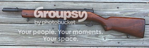

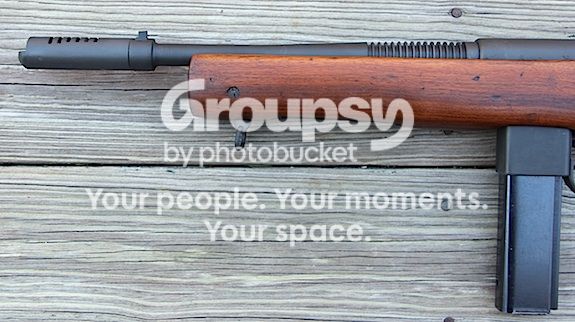

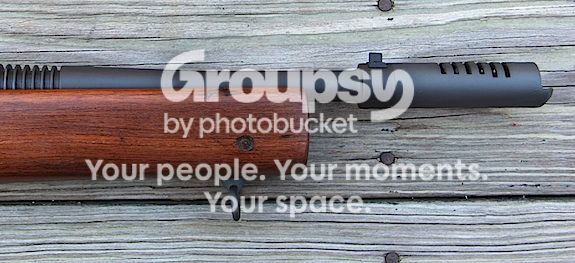

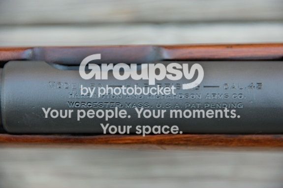

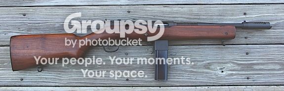

So I have a Reising on the way to me that should get here soon:
This unit comes from the collection of a former class three dealer from the state of Indiana. Clean bright bore and the later shorter 14 cooling fins. A nice grain walnut reinforced quick take down military wood stock.
The gun was sent to Andrewski of manchester n.h. for the once over - it received a complete new spring package as part of this service.
I have never even seen one of these guns but the price on this one was right! Only comes with one mag, so I am looking to pick up some more. Anything else I should buy?
Any tips or tricks for a new Reising owner would be much appreciated.
