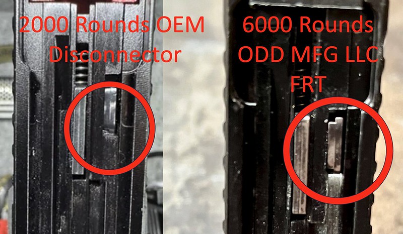

Heck mine has less wear than OEM disconnectors.
