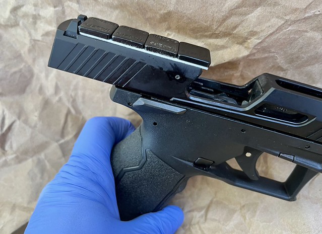

today's experiments:
Stick on wheel weights on top of the slide.
Host- 4.6" barrel Taurus TX22 Gen 2 non-optic cut slide and FRT.
SOWW added to top of slide with use with a 5.8oz SilencerCo Sparrow.
1 oz
CCI Subs 40gr -1411 RPM
CCI MM 40 gr - not functioning reliably
1.5 oz
CCI Subs 40gr -1293 RPM
CCI MM 40 gr - 1322 RPM
1.75 oz
CCI Subs 40gr -1104 RPM
CCI MM 40 gr - 1295 RPM
2 0z
CCI Subs 40gr - not functioning reliably
CCI MM 40 gr - 1253 RPM
This information seems to concur with illesdomer2005 guess that the 1.75 oz weight is the best for flexibility between subs and HV ammo.
It also appears that where and how the weight is added on the slide changes the numbers. Using a 3D printed box connected to the back plate, the ROF number were slightly lower. I will need to retest using 3-10 rd averages to verify.
