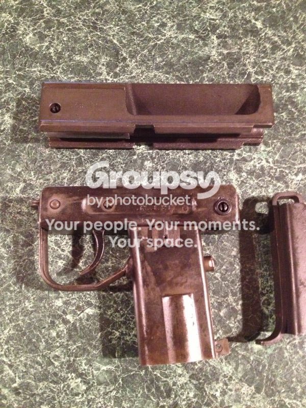

I recently purchased a Registered Receiver Vector Uzi. I went and picked up some of the items yesterday and the sale also included a 22lr kit and a 45acp kit.

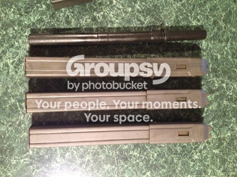

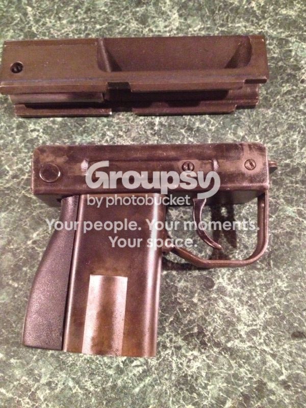

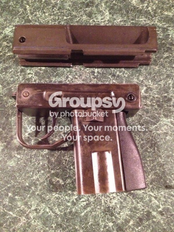

I have been doing some research, but can't find out a lot about the 45acp kits. I believe my 45acp kit is a grease gun mag well conversion. Below are pics of the kit. It came with 10 mags along with the bolt and barrel. Is there a market for these kits? How much are these kits worth along with the mags? I don't think I will ever use it and will probably want to get rid of it.
Any help or information would be great.
The first picture I forgot to screw on the mag release piece.

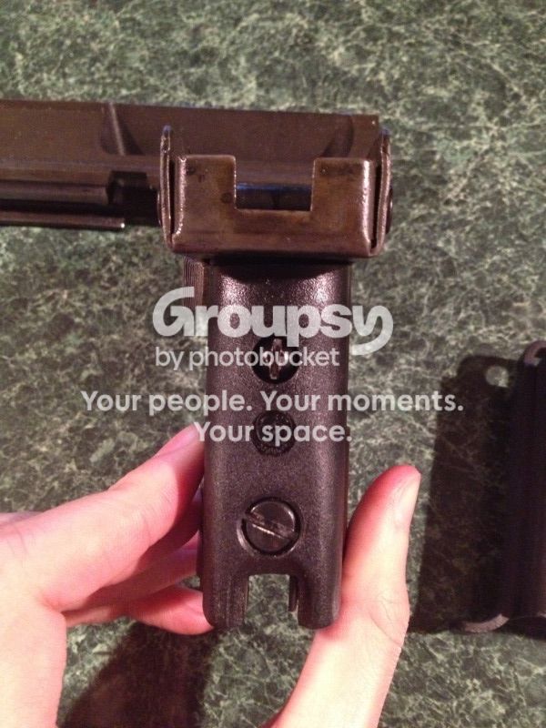

The mag well conversion is kind of crude, but I may be able have my buddy fix it. The welds are bad and he owns a machine shop and can fix things pretty well.

The bolt looks like an original IMI bolt, worth $4-500. My repro bolts are $375+. The barrel around $150. The magwell conversion kind of looks like a Roger Locke conversion. Should work great and you shouldn't have to mod the mags ever. Magwell conversion worth $325 min. $1000 package. If you do anything to the welds, just dress them down and try it.
Keep it you will like it. With that conversion you can go to 40S&W just by changing the barrel. Uses the same mags with feed lips straightened/narrowed
I've never seen a GG converted lower that had the mag well canted like that. Interesting.
I'd have to agree about not fixing it too much, better to have an ugly one that works than a pretty one that doesn't.
