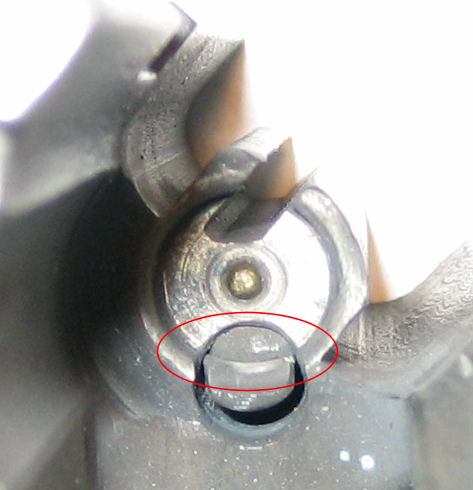

Has anyone actually tried sticking a 45 extractor in a 9mm SMG and to see if it works or not?
I just measured a 9mm extractor and it was 0.156 inches measured through the body at the highest point of the bump.
Maybe someone else can check theirs and verify.
ktk120
Oct 31, 2018
350
Who knows? Maybe a 45 extractor works great for 9mm?
Like i posted earlier apparently IMI has not made a 9mm extractor in 30 years, I heard at least that the 45 is supposed to be plug and play but in my case that has not proved to be true. As far as I know there is no source at all for 9mm only 45
4,820
That picture is from my website here: https://c3junkie.com/?page_id=457
I took that picture like 15+ years ago.
If you click on that link to my website above, I already did what you asked like 15+ years ago as well.
"If you install a .45 caliber extractor in a 9mm bolt, it will not sufficiently grab the case like a 9mm extractor would. The pictures below show a 45 extractor in a 9mm bolt on the left and a 9mm extractor in a 9mm bolt on the right."
Picture above is IMI 45 extractor in an IMI 9mm open bolt.
I remember I think 15+ years ago on these forums most people didn't even know there was a difference and that is why I took all those pictures. The reason why the discussions even came up back then was people were having reliability issues and one of the things to check was if you had a .45 extractor installed in your 9mm bolt.
Remember that a common problem running a 9mm extractor in a 9mm bolt is getting it so fouled up in the extractor hole that the extractor doesn't get close enough to the case like ....uhhh exactly what happens to running a .45 extractor in a 9mm bolt above.
Will it work? Depends. How hot is your ammo? Spring rate. Suppressed? Closed bolt vs open bolt? I think it is clear to see the extractor grab the case in the stock form without grinding down on the bump some.

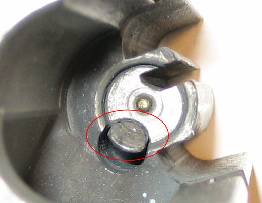

Picture below again from my website shows what a 9mm extractor looks like in an IMI 9mm open bolt.
Dirk Hawthorne
May 22, 2023
431
Pennsylvania
well, it certainly doesn't look like it would work that great
