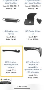

As of the minute (5:23PM CST 8/31/23) DSA has UZI extractors in stock for $25! I am not in any way affiliated with them, just sending the word out since they seem to be like hen’s teeth lately.

What a great thing to pass on! I've been stressing a bit over extractors. Over the years, I never thought they'd be hard to come by.
Hopefully these are the real deal and not from the same manufacturer as the SARCO ones?
No retaining pins though... Anyone point to a source for pins?
Thanks again, Navgunner!

RTG has the pins in-stock for $10. In my experience, the extractor is way more important than the pin but full disclosure I stockpile anyway
Personally I’ve never had a problem with DSA (knock on wood) and their listing says surplus, so I think we’re good to go. I know what you mean with the SARCO ones, they are absolute garbage.
Aside: DSA also carries the new style specific trigger parts, which is really uncommon on the surplus parts market. They’re pricey, but if you get them it gives you a lot of flexibility for the future. If someone needs help better understanding what that means or which parts I’m talking about please reference Richard Hoffman’s video about it on YouTube. Honestly, if you haven’t already… go watch all of his videos.
