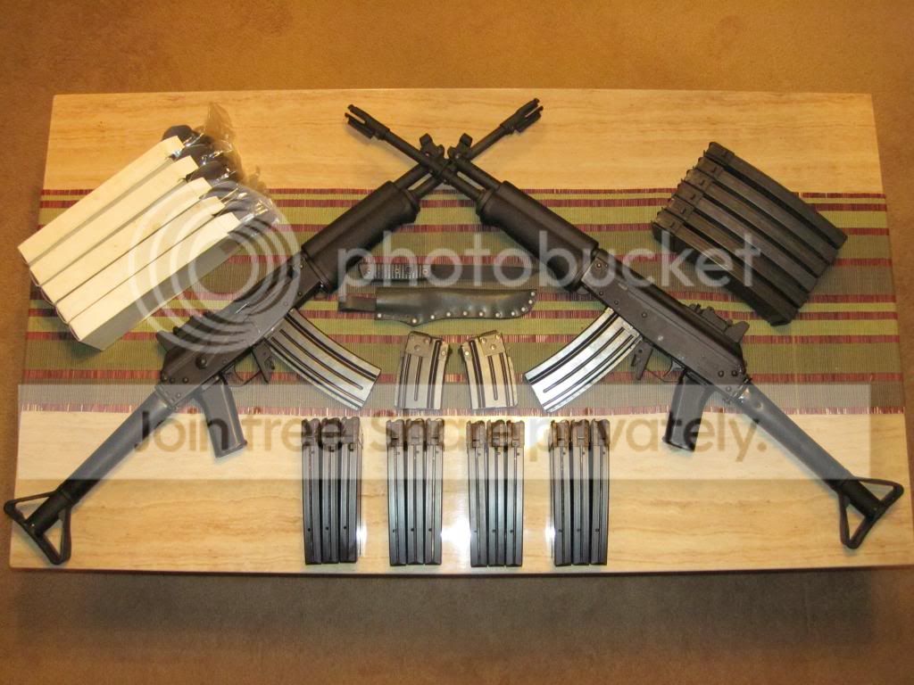

I've got a few of the MaxCapacityProducts 40 round magazines for the Valmet 76. You will also find them marked LIQ.
They don't run as reliably as factory 30 rounders in full auto but work fine on semi. Especially when only loaded to 35 rounds.
The feed angle isn't messed up like the vast majority of aftermarket/converted mags (Galil/Polytech) that people try to make work.
Only problem I've had was a broken plastic follower on one magazine. Haven't found a replacement follower that will work yet.
Max Capacity also made H&K 33 mags that look similar as well.
MCP/LIQ mags in boxes and top right of photo...the rest are factory Valmet.
