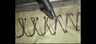

3,633
If you need more spring tension you can sacrifice one spring to make 3 magazines a lot stronger.
This works for MACs too, I use this method with my 50rnd Zmags. The 30s I simply put in a PAM2 spring.
Measure your existing spring and ad 15% to the length. Clip that amount off the donor spring and use a 1/8” roll pin to link them together. You may lose a round or two of capacity but should be more reliable in full auto.
