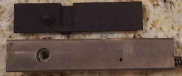

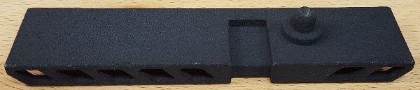

I would like to announce an exciting new product for those who are looking for another way to host your CF-W bolt, but don’t want to drop the cash on yet another new upper and everything else that goes along with it. If you already own a CF-W bolt in addition to a Lage Max-11 MkII or Max-11K (aluminum) upper, the W-Max MkII adapter allows for the drop-in use of your tungsten CF-W bolt with your existing uppers. Sorry, the adapter is not for use with the first generation steel Lage uppers, only the second generation aluminum (MkII) uppers.
The main benefit of using the CF-W bolt in your Max-11 upper is to keep the bolt mass lower and further to the rear rather than cantilevered over the barrel, greatly reducing the rocking effect during firing. Additional benefits include keeping your sights, stock and check weld consistent with what you are used to, and slowing down the ROF even more so than the Lage system – especially with the Max-11K.
To install, simply drop the adapter on top of your CF-W bolt, inserting the boss into the top charging knob hole. Slide the assembly into the upper and insert your existing Lage charging handle the same way as you would with the Lage bolt. It’s as simple as that.
Of course, this adapter can also be used with the stock M11/9 bolt in your Lage uppers the same way for fast-fire fun that is still safer and more controllable than your stock upper.
I would like to thank Mike (CoffeeFreak) for conceptualizing the conversion shortly after inventing his CFW bolt. His DIY conversion was the inspiration for this product, now available as a CF-W accessory for those who would rather not DIY.
VegasSMG.com is the exclusive distributor of these adapters and they will begin shipping next Monday, June 12th. The delivered price of $50 includes the W-Max MkII adapter as well as a super-slow fire recoil spring, and the system comes with a one year warranty from VegasSMG. This spring allows you to easily pull singles when using your CF-W bolt in conjunction with your excellent Max-11 MkII or Max11K upper.

The Lage MAX-11 Mk2 uppers are made from aluminum. The tungsten alloy the CF-W bolt is constructed from rides very smoothly and freely inside the upper which increases the ROF. To slow down this increased ROF, an SS spring, (Super Slow), is included with each W-MAX Mk2 adapter free of charge.

I had the privilege of being part of the test process on these wirh VegasSMG, and I was very impressed. I used it on my Lage K upper, and the feel/ROF of the heavy bolt in the larger Lage upper (vs a basic side cocking upper) is now my favorite Mac config. I'm going to put it to the real test in the local Subgun match this Sunday.

I tried to DIY one myself over the course of many range trips and eventually gave up. My Max-11k and CF-W have been waiting.
Care to share pics of the boss / interface?
