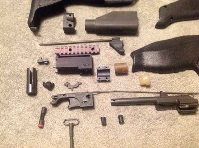

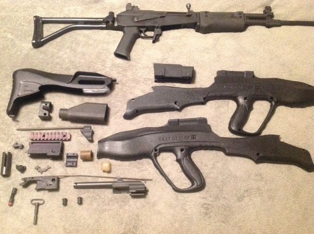

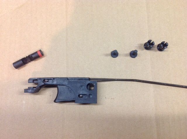

The guts are almost ready to install

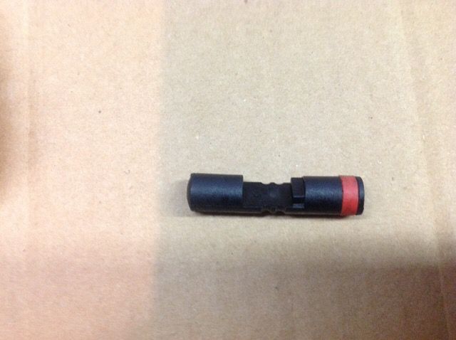

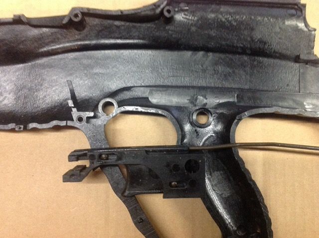

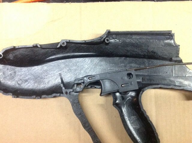

Shown here is the installation of the trigger and safety. There are two small plastic expansion pins that have the Vektor logo on them that hold the trigger assembly in place.

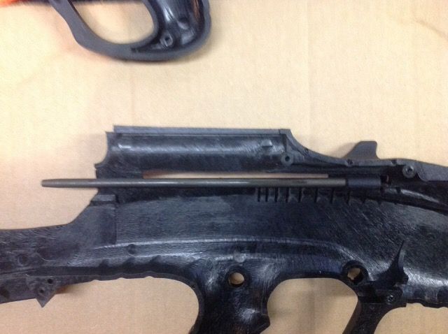

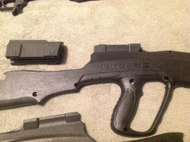

The next part to install is the heat shield. This includes the epoxy ring that centers the barrel. It covers the barrel as it exits the shell, there are slots in the top to facilitate the gas vent.
Here is the epoxy ring slid onto the barrel
[/URL]
As you can see here, the heat shield fits into this cut. The epoxy ring fits into the inside of the heatshield. This prevents debris from entering the muzzle end of the shell and allows the rifle guts to be removed without taking off the muzzle device.
[/URL][/IMG]
[/URL][/IMG]
Here is the heat shield fitted to the recess in the shell
[/URL][/IMG]

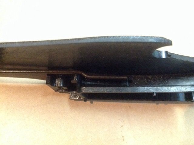

The shell retains the heat shield, trigger assembly and the charging handle.
[/URL]
You can see the trigger extension rod here
Charging handle view from the inside
Top view of the charging handle
[/URL]

sorry for the delay in updates, here are some more pictures of the build.
pictured here is the part of the expansion plug that retains the trigger the expansion plug has the Vektor logo on it
[/URL][/IMG]
here is the hole that both pieces fit in to retain the components
[/URL][/IMG]
[/URL][/IMG]
Here is the expansion plug with the logo
[/URL][/IMG]
Seen here is the outer piece being fitted
[/URL][/IMG]
Here is an inside view of the hole
[/URL][/IMG]
