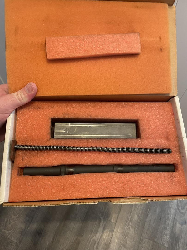

I’ve got a 40 S&W conversion kit made by barrel xchange (see below).
It appears that it will work with a few calibers too (obviously, for 9mm with this bolt, you’d need a 9mm barrel and so on). Apparently, you can use standard magazines too.
I haven’t tried this kit but appears to be really nice and well made.
