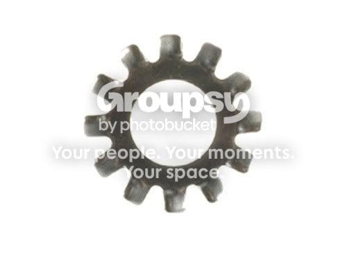

What kind of washer does Ruger use to lock their Flash Suppressor in place?
Picture?
Picture?
It is a star washer. It is the exact same washer that is used for the stock liner screws.

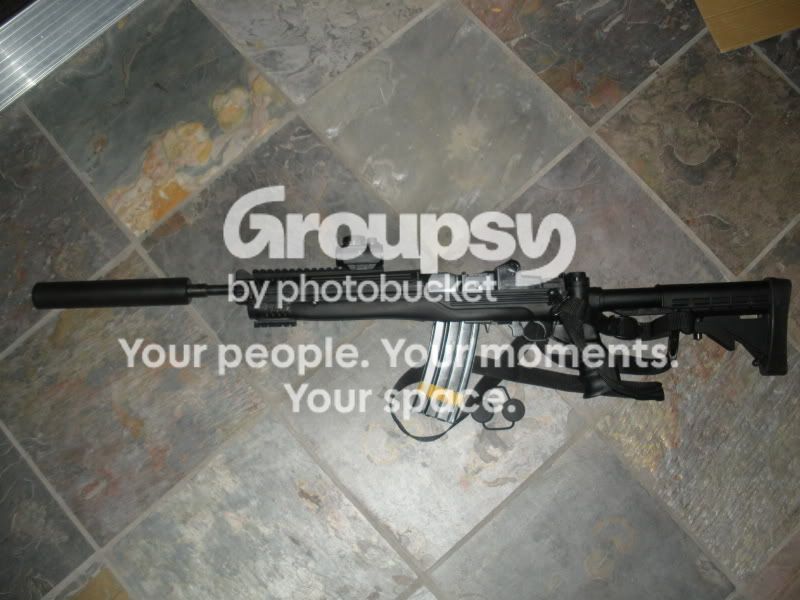

Thread adaptors came in today. Got one in 5/8" for my .30 cal can and one in 1/2" for my .22 can. The OutBack II will be for semi-auto only (maybe a few short bursts) but I've got a Thompson Machine full auto rated one on teh way and it'll be ran hard on the AC with the Ciener kit!!
Here it is with the .30 cal can on it. I"m going to load up a few subsonics and test them out in teh back yard later this evening....
Yes, the subsonics are VERY quiet!!
